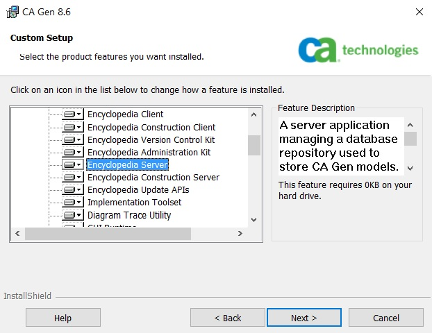

  3. Install the Gen software on new server.
    1. To install the CSE the Custom setup option needs to be used and feature "Encyclopedia Server" needs to be selected.
    2. If generating code from the CSE then feature "Encyclopedia Construction Server" also needs to be selected. The additional features for the Encyclopedia Clients and Encyclopedia Kits may also be useful to have installed on the CSE server itself.
