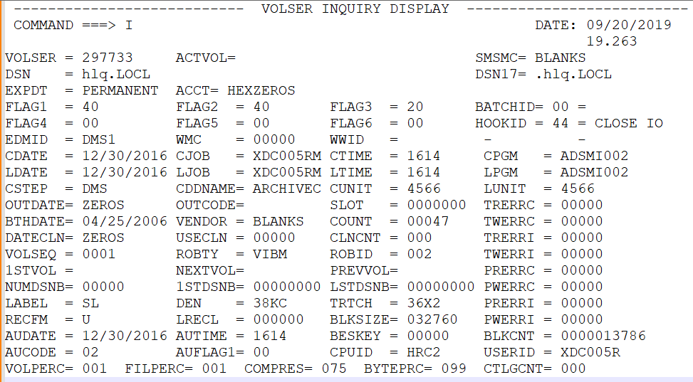

Hello,
We believe we're having a problem with DMS right now. We use CA-1 for tape management, which recognizes CA-Disk tapes as EDM. When I look at some of the tapes/keys in DMS some of the tapes report that there are many files on the tape, however when we try to display them DMS reports back that there are no files on the tape. I'll copy a screen from CA-1 and from DMS to show what I'm talking about:
From CA-1
--------------------------- VOLSER INQUIRY DISPLAY --------------------------
COMMAND ===> I DATE: 09/20/2019
19.263
VOLSER = 297733 ACTVOL= SMSMC= BLANKS
DSN = SYSXN.ENG.XDC005R.LOCL DSN17= .ENG.XDC005R.LOCL
EXPDT = PERMANENT ACCT= HEXZEROS
FLAG1 = 40 FLAG2 = 40 FLAG3 = 20 BATCHID= 00 =
FLAG4 = 00 FLAG5 = 00 FLAG6 = 00 HOOKID = 44 = CLOSE IO
EDMID = DMS1 WMC = 00000 WWID = - -
CDATE = 12/30/2016 CJOB = XDC005RM CTIME = 1614 CPGM = ADSMI002
LDATE = 12/30/2016 LJOB = XDC005RM LTIME = 1614 LPGM = ADSMI002
CSTEP = DMS CDDNAME= ARCHIVEC CUNIT = 4566 LUNIT = 4566
OUTDATE= ZEROS OUTCODE= SLOT = 0000000 TRERRC = 00000
BTHDATE= 04/25/2006 VENDOR = BLANKS COUNT = 00047 TWERRC = 00000
DATECLN= ZEROS USECLN = 00000 CLNCNT = 000 TRERRI = 00000
VOLSEQ = 0001 ROBTY = VIBM ROBID = 002 TWERRI = 00000
1STVOL = NEXTVOL= PREVVOL= PRERRC = 00000
NUMDSNB= 00000 1STDSNB= 00000000 LSTDSNB= 00000000 PWERRC = 00000
LABEL = SL DEN = 38KC TRTCH = 36X2 PRERRI = 00000
RECFM = U LRECL = 000000 BLKSIZE= 032760 PWERRI = 00000
AUDATE = 12/30/2016 AUTIME = 1614 BESKEY = 00000 BLKCNT = 0000013786
AUCODE = 02 AUFLAG1= 00 CPUID = HRC2 USERID = XDC005R
VOLPERC= 001 FILPERC= 001 COMPRES= 075 BYTEPRC= 099 CTLGCNT= 000
