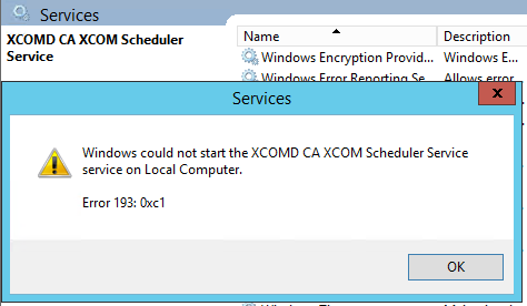

Just installed XCOM Data Transport for Windows Server. Based on documentation first thing to do is to start windows scheduler service.
And
The action returned the following error:
Below Windows Event Log
The XCOMD CA XCOM Scheduler Service service failed to start due to the following error:
XCOMD CA XCOM Scheduler Service is not a valid Win32 application.

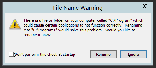

This issue is caused when a file or folder called "C:\Program" is present on the installation drive.

Client found file named c:\Program file and renaming it to "c:\Program1" resolved the problem.
If the File Name warning below appears when starting a new interactive session
Choose "Rename". This will rename the offending File or Folder to "C:\Program1" and the issue will be corrected.
