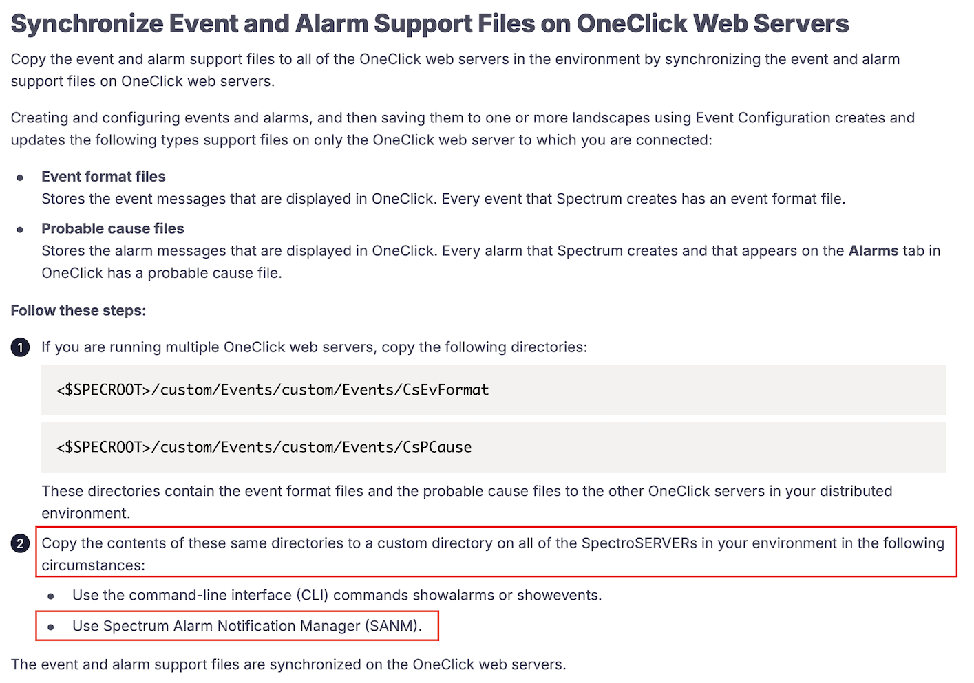

This can also be caused by not having the CsEVFormat files copied from OneClick to the server where AlarmNotifier is running.
When a custom event is created in the OneClick Event Configuration Editor, we save a copy of AlertMap and EventDisp files in the custom directory on the SS and save the Pcause and EvFormat files on the OneClick server. If you use Alarm Notifier though, the Pcause and EvFormat files would also have to reside on the SpectroSERVER so Alarm Notifier can process them.

If you use the Command Line Interface (CLI) commands ./show alarms or ./show events, or SPECTRUM Alarm Notification Manager (SANM), then you will want to copy the contents of these three directories to all SpectroSERVERs in $SPECROOT/SG-Support.
However, due to the risk of custom files getting overwritten, they should be placed into one of the two custom directories mentioned previously.

If you copy the custom pcause and EvFormat files from the OneClick server to the SpectroSERVER to any one of the two custom locations then AlarmNotifier should be able to use these custom pcause files.
