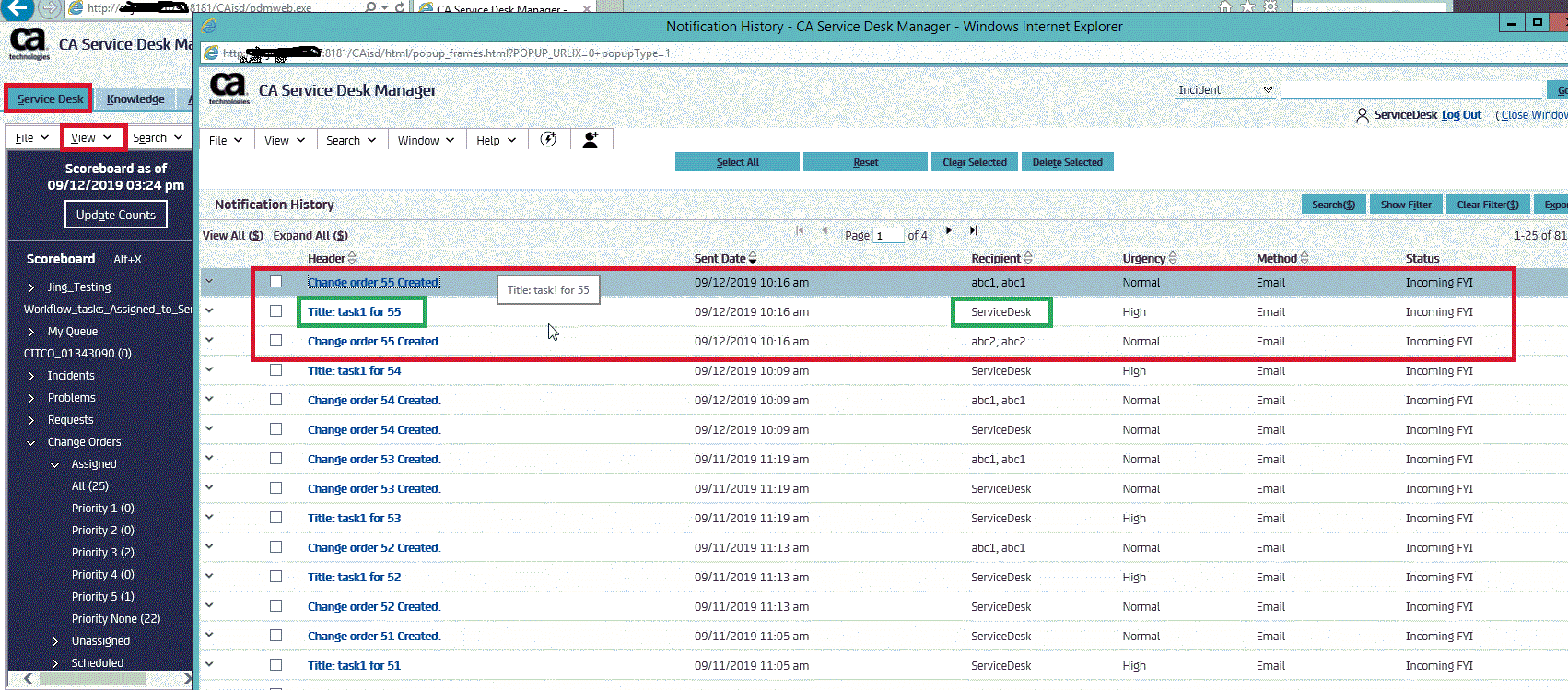

By the current design, the workflow task email notifications can not be seen from the ticket's view, but can only be seen from the overall notification view (i.e. Service Desk tab (as administrator)  -> View -> Notification History)).
If you need to do an "audit"  the Work Flow Task E-mail notification, you will have to go to the Service Desk tab (as Administrator), and go to View - > Notification History to search and find it there instead of the ticket itself's View -> Notification History. In other words, Work Flow Task notifications cannot be seen from the ticket view, but can only be seen from the overall notification view (i.e.  Service Desk tab -> View -> Notification History).

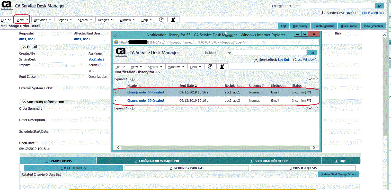

For example, you can see: For Change Order ticket 55, in Service Desk tab -> View -> Notification History, it lists the email notifications to ticket 55's assignee (abc2 ), Affected End- User (abc2),  and also one pending wf task1's assignee (ServiceDesk). However, in Change Order ticket 55's View -> Notification History, it does not have e-mail notification to Work Flow task1's assignee (ServiceDesk).
Notification History in Service Desk tab -> View  :
Notification History in Change Order ticket 55's view:
