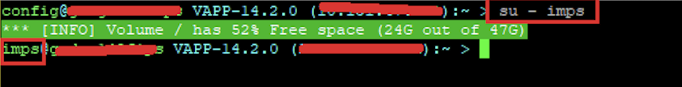

1. Log in to the Virtual Appliance with config/ec2-user user credentials.
2. Switch user config/ec2-user to imps using su – imps command.

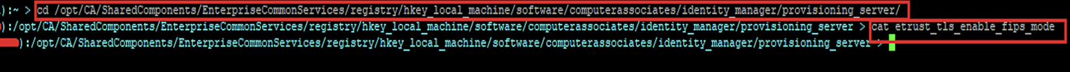

4. If FIPS mode is enabled, navigate to
/opt/CA/SharedComponents/EnterpriseCommonServices/registry/hkey_local_machine/software/comput
erassociates/identity_manager/provisioning_server/ and run cat etrust_tls_enable_fips_mode. You must
see the output yes on the screen.

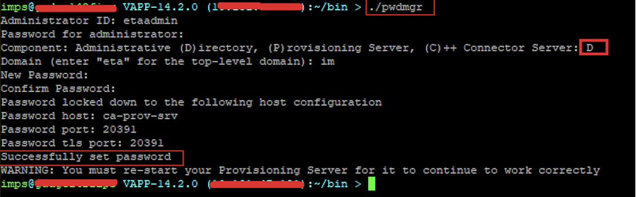

6. Run ./pwdmgr to update the Provisioning Directory password for im domain. Follow the screen below and
enter values as appropriate.

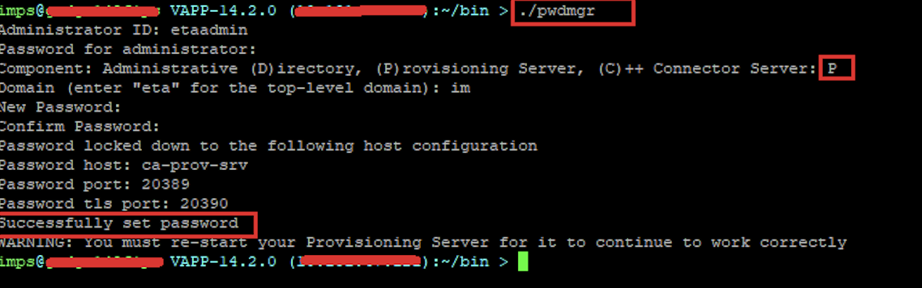

7. Run ./pwdmgr to update the Provisioning Server password for im domain. Follow the screen below and

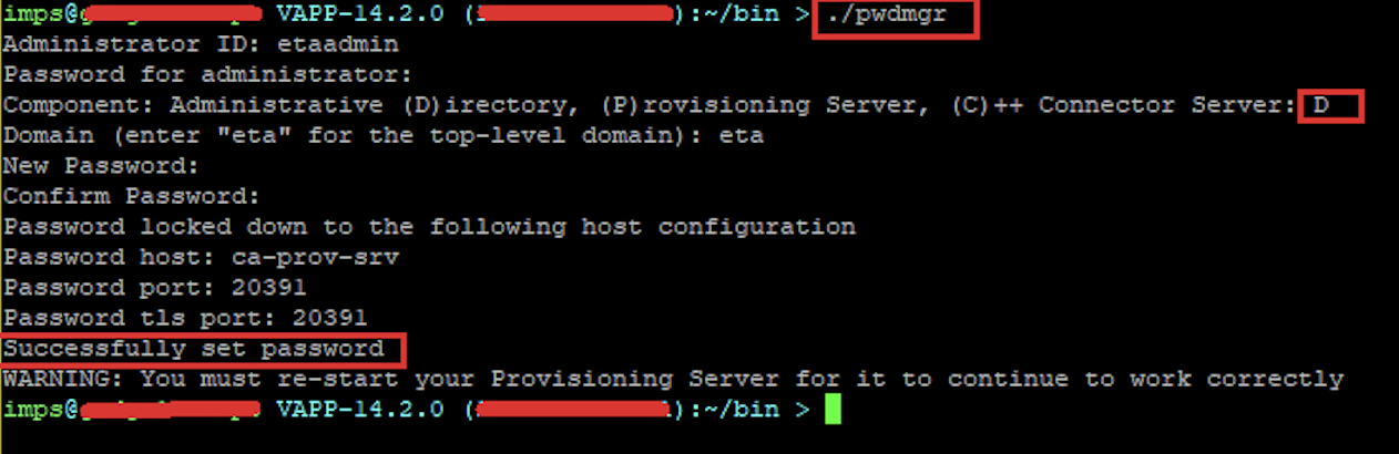

8. Run ./pwdmgr to update the Provisioning Directory password for eta domain. Follow the screen below and

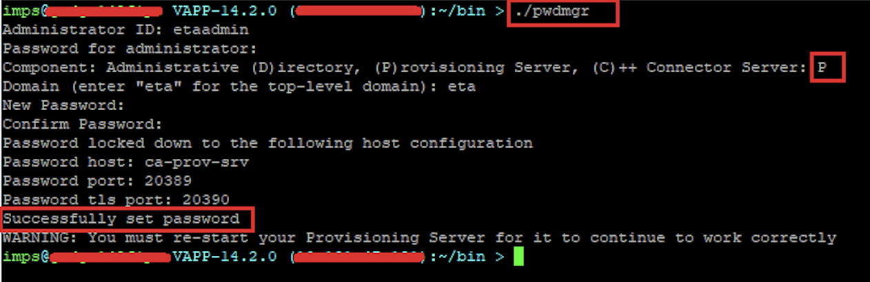

9. Run ./pwdmgr to update the Provisioning Server password for eta domain. Follow the screen below and
