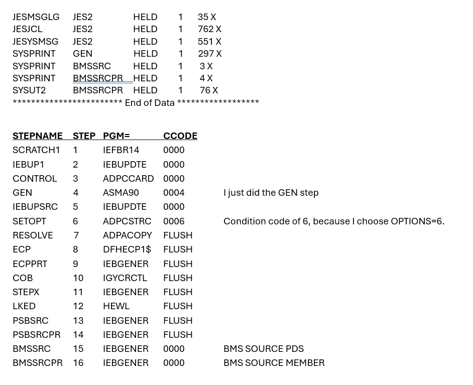

13. The output of this job generated the following steps:
14. Here is the BMS source that Telon generated, ready to be assembled. Notice the name MARILYN that we used in the TDF.
