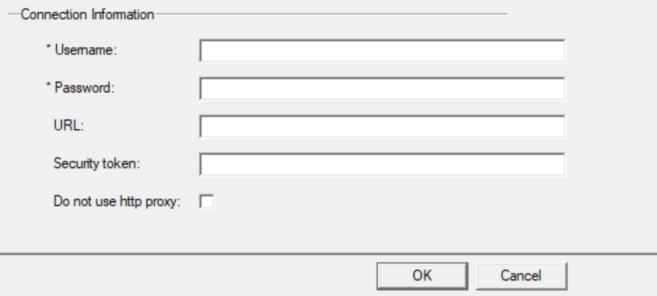

1. Confirm the Token and URL are set correctly on the Endpoint Configuration.
Sample Image:
You can access this information in two ways, within IDM or Provisioning Manager. The above screenshot is from Provisioning Manager.
Provisioning Manager Steps:
Endpoints > Salesforce Endpoint > Search > Right click on your endpoint and select properties or double click > Make necessary changes.
