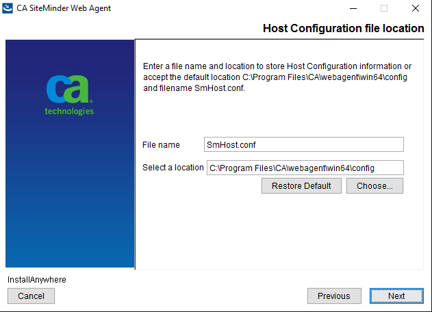

Run Agent Configuration Wizard for Host Registration.

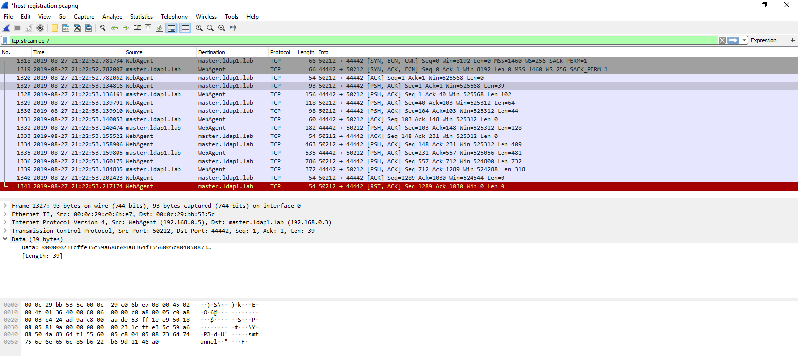

At this point smreghost is run, smreghost opens TCP ephemeral port to connect to Policy Server.
In this case it was port 50212
Smreghost will connect to Policy Server's 44442 (Authentication) Port for registration.
Please ensure TCP port 44442 is open for smreghost to succeed.
Once TCP Handshake is complete, WebAgent will send the Registration Information. Only 1 TCP connection is required to complete host registration.
Connection should be initiated and terminated from Web Agent.
Refer to attachment "smreghost.pcapng"
Web Agent uses a predefined Tunnel agent called "smtunnel" and also sends the SiteMinder Administrator name appended to it as "smtunnel-siteminder".
Policy Server would perform the TrustedHost registration once this is successful.

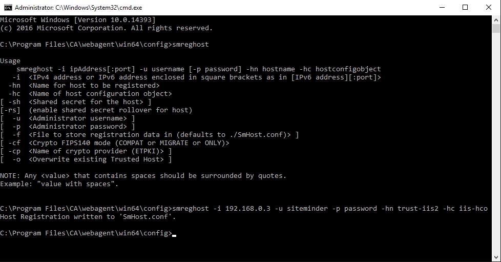

Trusted Host Registration can be done via Agent Configuration Wizard (which is the above) and can be done via command-line.
Refer to Attachment: smreghost2.pcapng
