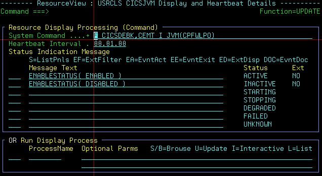

After reviewing your messages I think a USRCLS resource set up as follows should do the job.
I called the resource CICSJVM for the purposes of this exercise.
NOTE: you will need a couple of processes as well, that I have called JVMSTART and JVMSTOP, which I will also cover here.
Firstly, the Display and Heartbeat screen:
NOTE: I have used a 1 minute heartbeat. You can set whatever value works for you.
https://api-broadcom-ca.wolkenservicedesk.com/es/attachments/get_attachment_content?uniqueFileId=508423620581

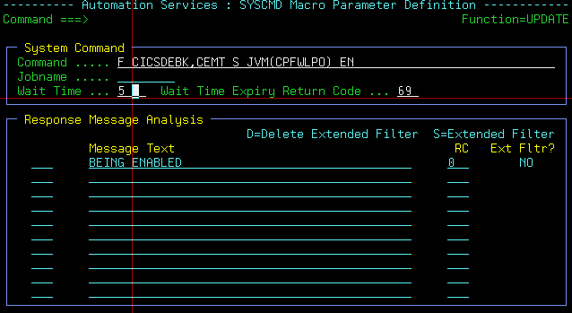

This uses a PROCESS called JVMSTART.
The PROCESS looks like this:
The PARAMETERS for S1 look like this:
It will return RC=0 if it sees "BEING ENABLED" otherwise it will timeout after 5 seconds and return RC=69
https://api-broadcom-ca.wolkenservicedesk.com/es/attachments/get_attachment_content?uniqueFileId=508464834194

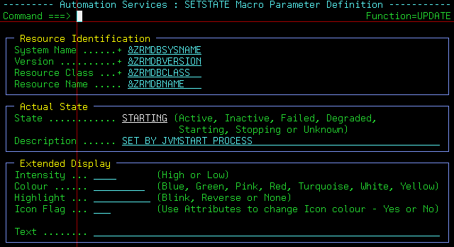

The PARAMETERS for S2 look like this:
It is run if S1 returns RC=0 and sets the state of the resource to STARTING
https://api-broadcom-ca.wolkenservicedesk.com/es/attachments/get_attachment_content?uniqueFileId=508429260315
The PARAMETERS for S3 look like this:
