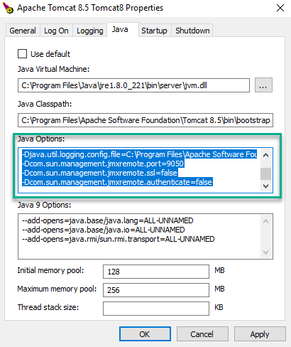

If you are using Windows, it is easiest to set this in the Tomcat properties (Tomcat8w.exe):
