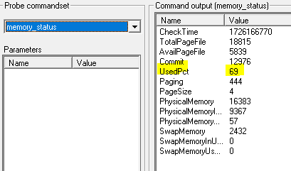

1. right click on the CDM probe and access the probe utility
2. Execute the memory_status callback This will return a list of values.
3. The UsedPct is the value stored for QOS_MEMORY_PERC_USAGE
