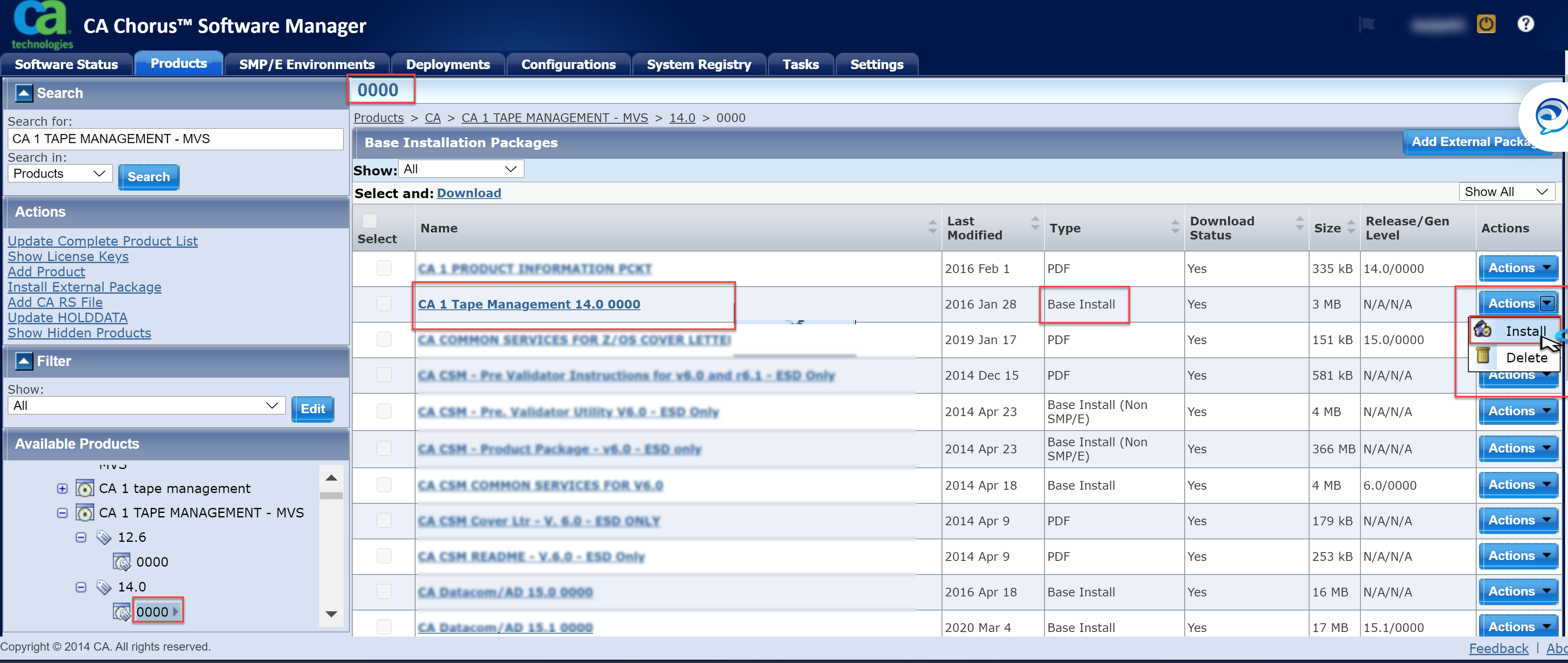

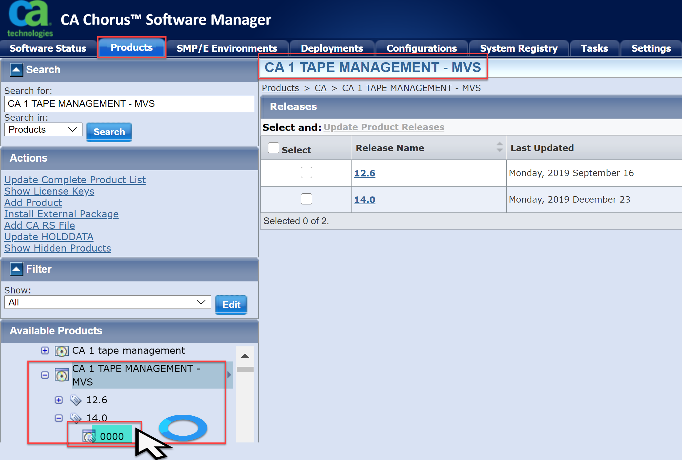

Below is an overview of the steps to install CA 1 TAPE MANAGEMENT - MVS 14.0 using CA CSM:
1. Click the Products tab and find CA 1 TAPE MANAGEMENT - MVS and under the release 14.0 select the gen level 0000.
2. Find the Base Install for CA 1 TAPE MANAGEMENT, click ACTION on right and then select Install
4. Review and click NEXT through the pages noted below until you get to the page where the INSTALL button becomes ACTIVE
5. To begin the installation click the INSTALL button.
