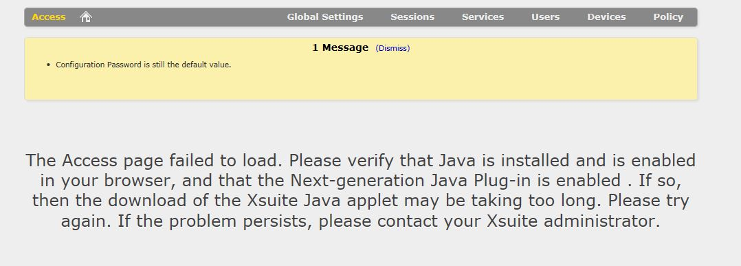

It is not uncommon when using CA PAM to encounter problems on the Access page.  To start with, you must understand that the environment on which CA PAM depends.  CA PAM uses Java throughout its code.  The Access page is one place and the LDAP browser is another.  If Java is not installed, or cannot be loaded then the Access page will not load.  You will recognize this as the problem by seeing something like in the picture below.
Please note that this document requires an update, as the GUI has been updated, and OpenJDK is now used.  The general procedure still applies.
In order to load the access policies CA PAM needs to run a Java applet.  In the picture above you can see that it is attempting to load the necessary applet.  The icon will continue to spin for a while and will eventually time out, and no policies will load as a result.  This means that the user will not be able to perform their job, as they have no way to connect to the required devices.  The picture below shows the message seen after the timeout.
