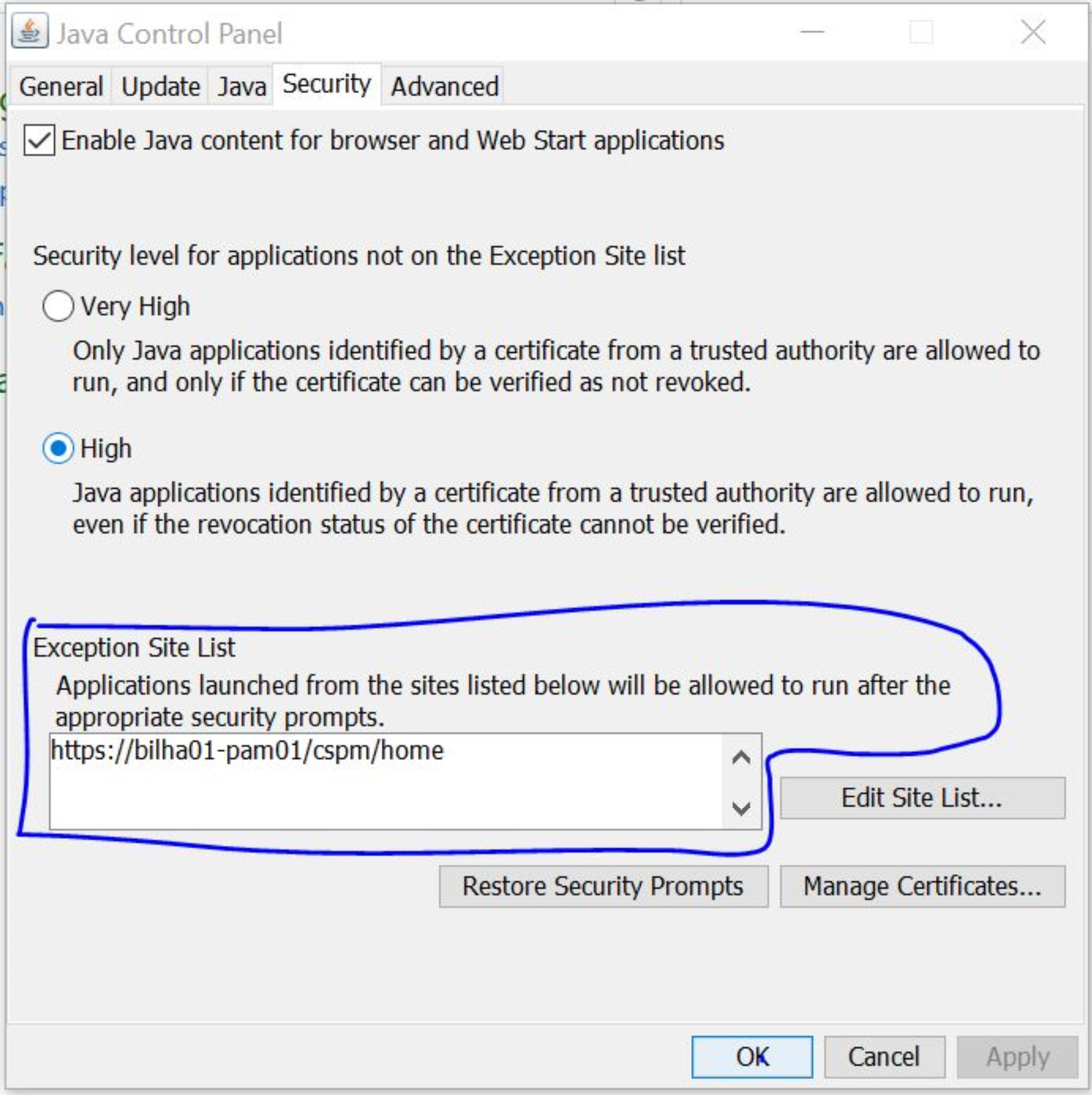

Due to the changes in the security enforcement in Java itself, it is common to find certain sites need to be added in the exception list.
Add PAM Server URL to the exception list.

  • Add  IP or host name in the exception list of control panel->java->security
