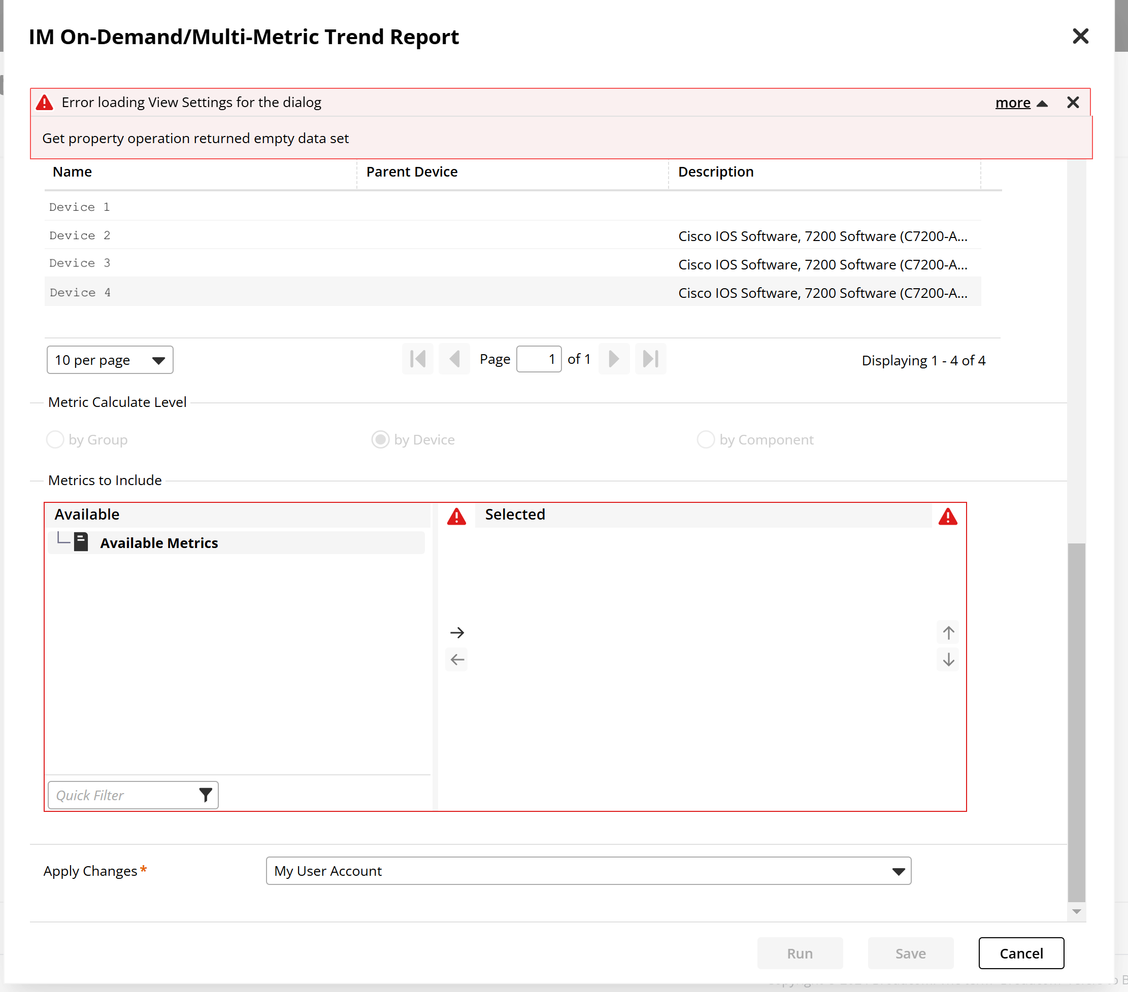

On-demand report in CA Performance Management (CAPM) fails with error - "Get property operation returned empty data set"
On NetOps Portal from Reports->New, I get below error and the template run & save options are grayed out.  I also noticed there is no available metrics to select. We only have a Spectrum Data Source integrated with Portal.
When running an on-demand report for any device or group in CAPM, the following error is seen: "Get property operation returned empty data set"
