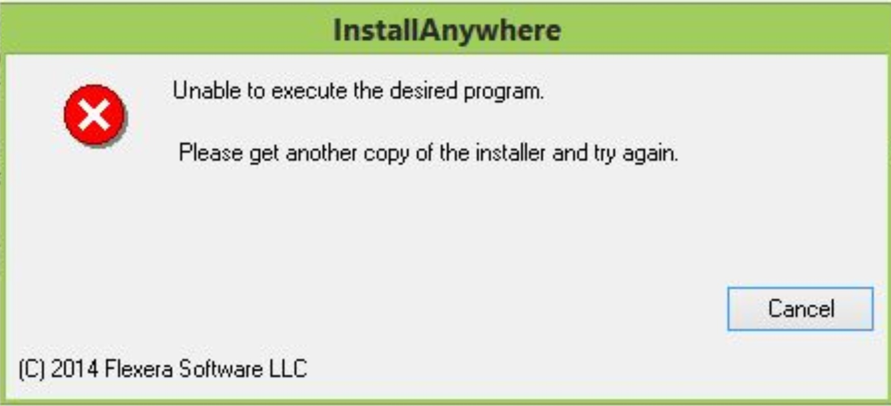

CA PAM client related .exe file (C:\Users\"USERID"\CA PAM Client\CAPAMClient.exe ) when "Run as an administrator" fails with this message as shown below.
Windows 10
This is a permissions related issue where running as an Administrator, the Administrator account on Windows laptop has to activated

As this installer error can be encountered due to other issues on a Windows system.  Sharing some related remedies.
Try re-installing after trying each of the steps below:
  • Disable your firewall and anti-virus software (and all security software run the CA PAM .
  • Clear your web browser's cache.
  • Try downloading using a different web browser.
  • This error could also be due to a corrupt file associated with InstallAnywhere located in a Temp folder on the local machine. To correct the error, clear all files in the local Temp folders:
    • C:\Temp
    • C:\Windows\Temp
    • C:\Documents and Settings\\Local Settings\Temp
    • C:\Users\\AppData\Local\Temp
