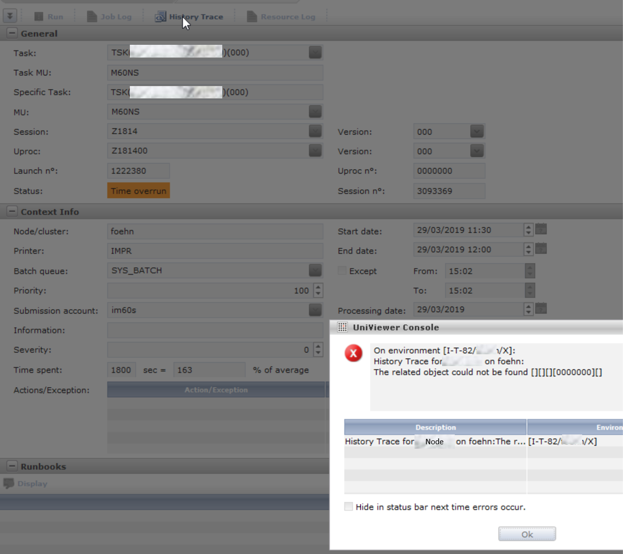

A week before the DST time in Europe ( since 24th March 2019), some Jobs scheduled by a Task go straight to "Time overrun" status when they are supposed to be Launched (Start date)  instead of waiting until the end of the Launch Window (End date).
They can be easily identified as they have as Uproc nº 0000000
When trying to display the History Error, a popup error appears in Univiewer Console as the History Trace was not created:
There is no reason for this issue as the Launcher was up and running, and the universe.log does not contain any Error.

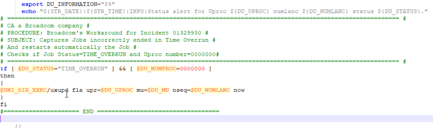

b) Automatic action via u_spv_com.ksh script to be triggered via an Alerting Rule.
1. Create and Enable via UVC - Operations Settings the following Alerting Rule or modify the existing one so that it is launched for all jobs in Status Time Overrun.
2. Then edit the script u_spv_com.ksh of the impacted node/s via Node Settings - Node Files:
Add from line 64 the following:
# CA a Broadcom company #
# PROCEDURE: Broadcom's Workaround for Incident 01329930 #
# SUBJECT: Captures Jobs incorrectly ended in Time Overrun #
# And restarts automatically the Job #
# Checks if Job Status=TIME_OVERRUN and Uproc number=0000000#
if [ $DU_STATUS="TIME_OVERRUN" ] && [ $DU_NUMPROC=0000000 ]
then
$UNI_DIR_EXEC/uxupd fla upr=$DU_UPROC mu=$DU_MU nseq=$DU_NUMLANC now
fi
#===================== END ==================================
Example:
3. Save and close, the script u_spv_com.ksh should have execution rights for all users.
-rwxr-xr-x. 1 univa univa 3902 Mar 29 11:07 u_spv_com.ksh
4. In case of new occurrence, the Job should be automatically relaunched.
