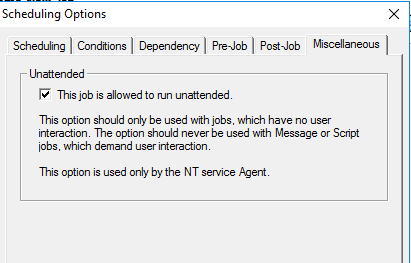

4- Click Next and click on "Set Scheduling" button.
In Miscellaneous tab, check the option "This job is allowed to run unattended"
5- Click OK and Finish button. The Asset Job is created.

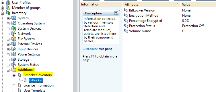

7- During next execution of AM Agent on the machines, bitlocker job will be executed. And bitlocker inventory will appear under Additional folder in DSM Explorer
