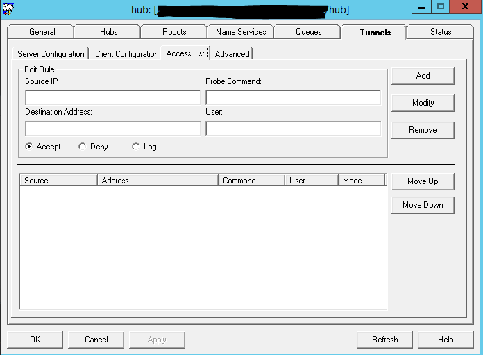

The taccess messages in the primary hub are referencing the Access List found in the hub tunnel configuration.  When these access lists are configured, tunnel communications can be blocked.
Removing any entries in the hubs Tunnel Access List will allow communications over the tunnel to be unrestricted.
