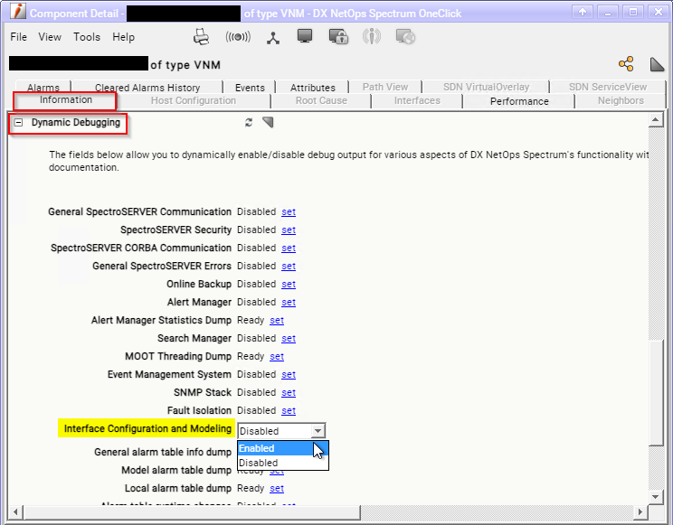

Enabling the Interface Configuration and Modeling debug you may notice in the debug output "if_state is: 2" This is the cause of the message: SPC-OCA-10448 Another reconfiguration is currently in progress. Only one reconfiguration at a time is allowed per device. Please try again later

Check the attribute if_state on the device model. If the attribute if_state=2 that means the model is still getting created and hence the Reconfiguration is not being allowed, change it to 1 (if_state=1 Model_Active), this will allow the Reconfiguration to properly run.
