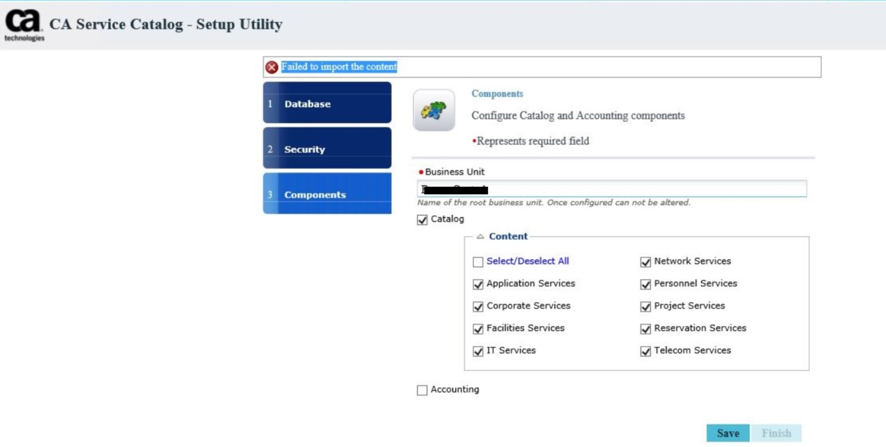

Service Catalog and SDM have a shared MDB and both were upgraded to 17.1.
When using Setup Utility to finish Catalog's upgrade, in the component section fails with error "Failed to import the content":
Service Catalog 17.1
Service Catalog 17.4 (See additional information for possible reference)
Reviewing "seeddata.log" file (located in C:\Program Files\CA\Service Catalog\logs\install), the following error appears while the import procedure is executed:
 ERROR Exception while communicating with the database:The ALTER TABLE statement conflicted with the FOREIGN KEY constraint "XFKusm_contact_domain_role1". The conflict occurred in database "mdb", table "dbo.usm_tenant_ext", column 'tenant_id'.
com.microsoft.sqlserver.jdbc.SQLServerException: The ALTER TABLE statement conflicted with the FOREIGN KEY constraint "XFKusm_contact_domain_role1". The conflict occurred in database "mdb", table "dbo.usm_tenant_ext", column 'tenant_id'.
This means that table "usm_runtime_component" is empty, causing that the constraint can't be completed bu the installer. This can be reviewed with the following query:
SELECT * FROM usm_runtime_component
In order to solve the issue, this table must have data in it, with the following query a line can be added to solve this issue:
INSERT INTO usm_runtime_component
VALUES ('Scheduler',NULL,NULL,NULL,NULL,NULL)
After this the component deployment can be re attempted.
