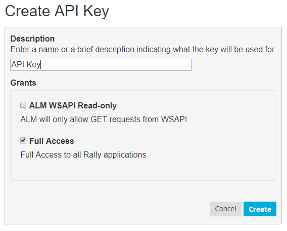

This scenario is actually a combination of the above two issues. Under normal circumstances, a read-only key trying to POST would result in a 401 error. However when using a read-only key in the presence of an established session it is guaranteed to try and use the credentials from the established session and will fail.
An extenuating condition where this is seen with full-access keys, is one where invalid POST operations have been attempted and subsequently the "Invalid key" response has been cached for that request by a proxy. If there is a caching proxy server in use at your location, then there is no control over that from an Agile Central perspective and you will need to work with your network team to adjust rules to prevent responses from being cached.
