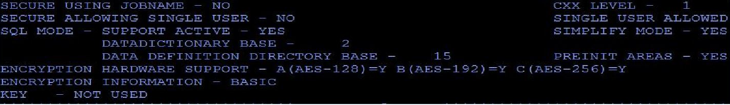

  3. Produce CXX report in DBUTLTY:
    //SYSIN DD *
    REPORT AREA=CXX,TYPE=K
    You should now see RECOVER - YES ENCRYPTION - B(BASIC) C(AES256)
