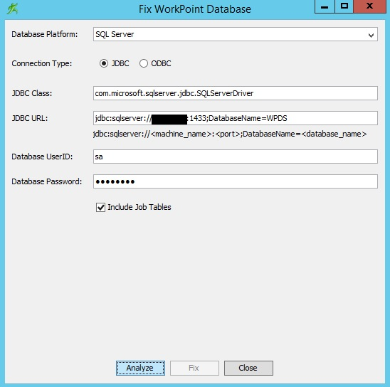

Note that the program hooks directly to the database via JDBC, it does not go through the WorkPoint Server. Make sure your SQL JDBC driver of choice is in the classpath as set up in the IdCheck.bat

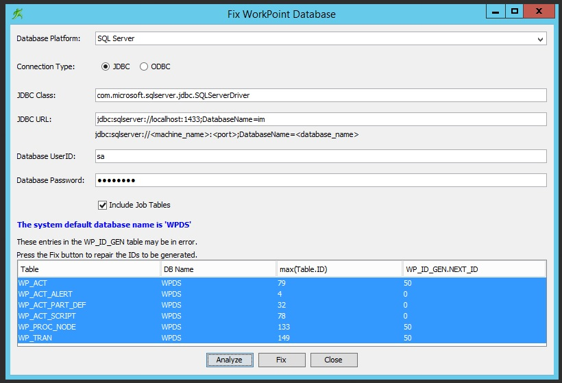

Once the connection to your database is configured in the window, press the Analyze button. Any tables that are out of synch will be displayed and highlighted, and the Fix button will become active.
In the example below you can see ID Check being used to connect to the Work Point Database (WPD) hosted on an external MS SQL Server Database.
Press the Fix button, and when it's finished it will confirm with a dialog "The Selected table(s) were fixed" and a subsequent dialog "There are no entries that currently need to be fixed".  You may now close out of IdCheck and restart your Work Point Servers or in the case of the vApp restart_ig.
