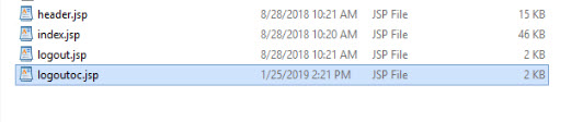

5. Next, navigate to the $SPECROOT/tomcat/webapps/spectrum/webclient
6. Copy the logout.jsp to the same location as logoutoc.jsp
7. Confirm the permissions on logoutoc.jsp are NOT read-only.
8. Open the logoutoc.jsp in a text editor.
9. At the very bottom, the following code will be seen:
<h1>You are now logged out </h1>
Click <a href="/index.jsp">here</a> to Re-Login.
Change this to:
Click <a href="../index.jsp">here</a> to Re-Login.
10. Save the file and exit.

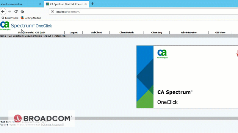

A logout option should now be seen:
