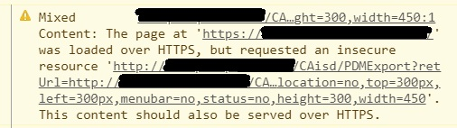

End users are trying to run an export of tickets.
During the export attempt, they are receiving a message for Mixed Mode content in the Browser Console:
The page at https://URL.DOMAIN.COM was loaded over https, but requested an insecure resource http://SERVER:8080/CAisd/PDMExport
Service Desk Manager 17.3.x and 17.4.x
The issue is due to Chrome and Firefox enforcing the Mixed Mode restriction.
Such browsers generally prohibit content being presented by an http and an https source simultaneously.
If such a scenario arises, the site is blocked and would require a reload of the page to override the restriction.
However, a reload of the page here would result in the end user having to log back into Service Desk.
