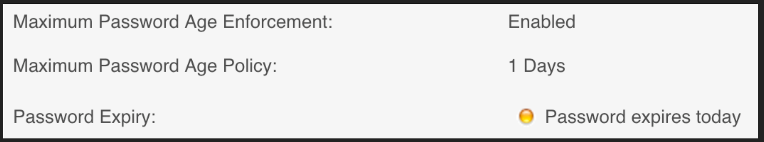

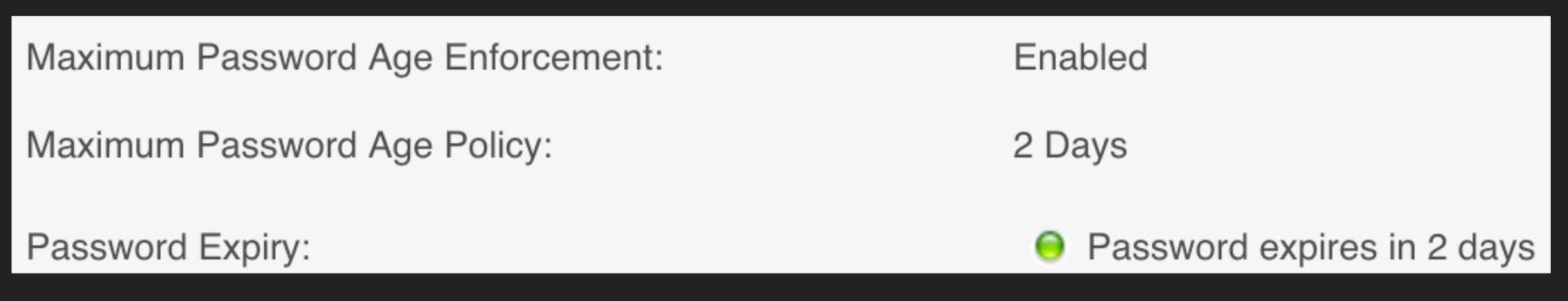

How can the current expiration status of an account be checked?
To check the status simply navigate to Credentials > Manage Targets > Accounts, then open the account and change to the Password tab. This will show the account information including expiration information like the examples below:
The account above is already expired, here are some examples of the other statuses that may be seen:
