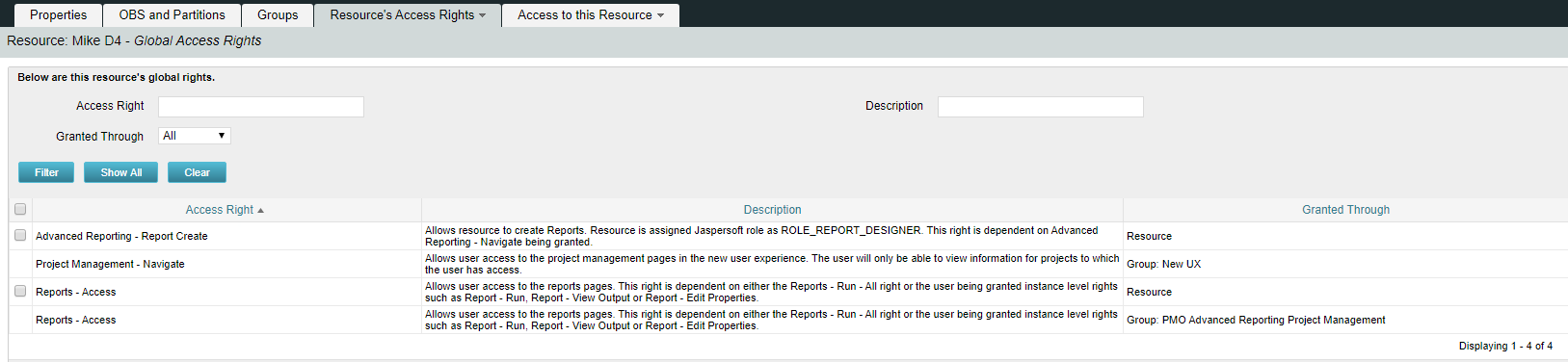

Below are minimum access rights to run the reports from Clarity PPM Reports and Jobs:
  1. At least one Advanced Reporting access right is needed because the user has to exist in Jaspersoft. When the job runs it only picks up ppm users that have been given advanced reporting access rights.
    • Grant the Report create right - even though right name says "create", it's not for the creation, it's for execution of the report
  2. Report - Access (global right) to see reports and jobs from the Application the sub menu
  3. User should be added to one of the Clarity PPM PMO Advanced Reporting Groups or any of the custom groups the user is maintaining in Clarity. For example, go to Administration > Groups > add the user to 'PMO Advanced Reporting Project Management'
    • When a user is added to the PMO Advanced Reporting group in Clarity, there is a corresponding CSK Role in Jaspersoft Advanced Reporting > Manage > Roles.
    • Because the ID's are the same when you run the Synchronize Jaspersoft Roles job the user automatically gets the CSK Role, which means now user is able to access the reports for that particular project, product, application for what ever group he is in.
  4. Run the Create and Update Jaspersoft Users and Synchronize Jaspersoft Roles jobs
    • Please note,  in Administration > System Options the Allow Jaspersoft Role Synchronization option needs to be enabled or the Synchronize Jaspersoft Roles Job will error with "Enable the system option 'Allow Jaspersoft Role Synchronization' and execute the job again.'

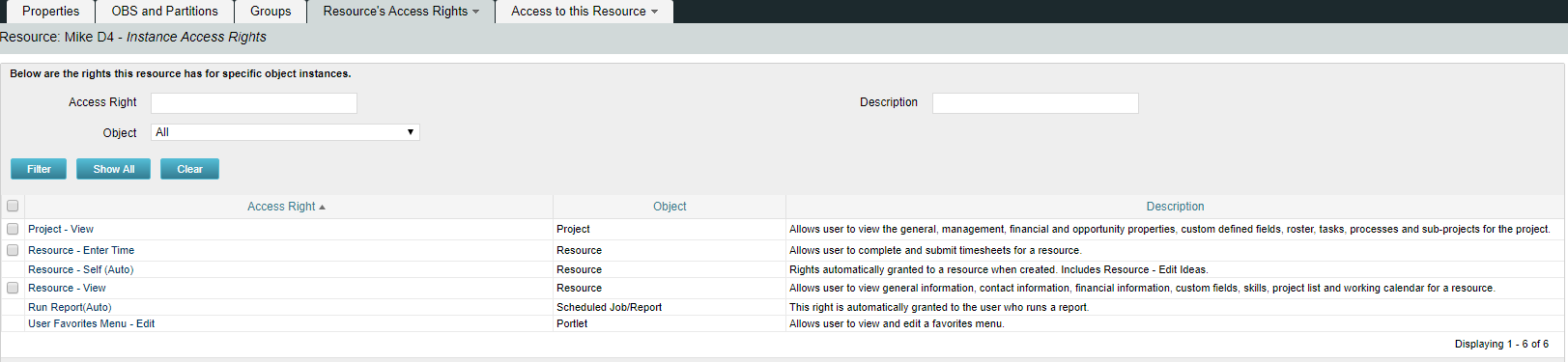

  5. The Clarity rights are needed for the purpose of seeing the data in the report and when you click on the report parameters you should see some values. The rights to the Clarity data are required and depending on which report you are running user may need additional rights to run the report and see the data.
The example shown here are the needed Clarity rights to allow user to run and download the PDF Project Status Detail report, and see the report data:
  • Resource - View (Instance right on few resources)
  • Project - View (Instance right on few projects)
  • Advanced Reporting - Report Create (Global)
  • Reports - Access (Global)
