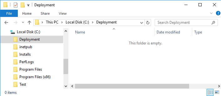

Yet, checking the example-agent server, no files were deployed:
