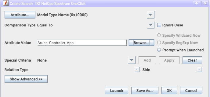

  • Discover the Aruba_Controller_App/Cisco_LWAPP_App models using the Locater
  • Select all of them in the Results tab

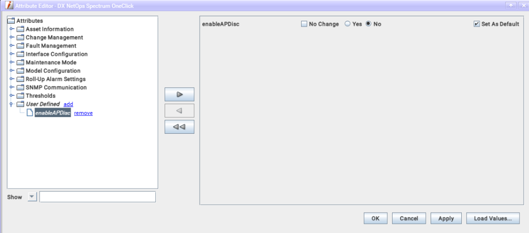

  • Right mouse click on any one and select Utilities -> Attribute Editor from the menu
  • Click on the blue add link
  • Find the enableAPDisc attribute and select
  • Move the enableAPDisc  to the right
  • Uncheck the "No Change" check box
  • Check the "No" check box
  • Check the "Set As Default" check box
  • Click Apply button
