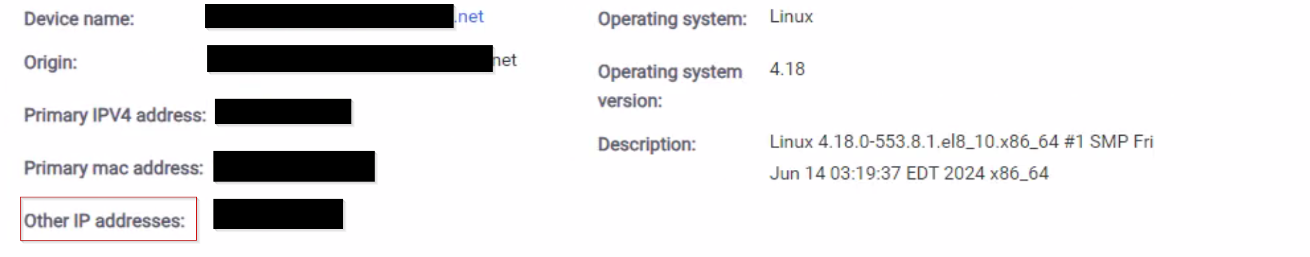

This will be caused by a system that was cloned and now has a new hostname and IP address, but the robot.cfg has the old robot name and IP address.
This is why when you go to the cdm probe on the correct machine you do not find the  drive in monitoring but you are still getting an alarm, or the values are completely incorrect, because they're actually coming from a different machine.
One clue for this is that the device which the alarms attach to will have an IP address under "Other IP addresses" that is not actually assigned to that machine.
The machine that actually owns the IP listed here is likely the machine that has received the cloned image and still has the identifiers for the original robot.
