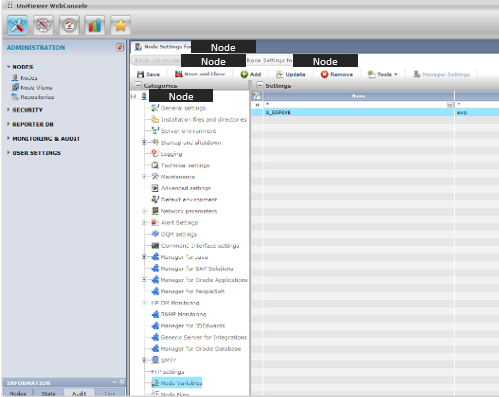

This can be detected via the command line:
[root@hostname bin]# ./uxlst nvar varname=S_ESPEXE
 Commande : uxlst nvar varname=S_ESPEXE
NODE VARIABLE                                                    VALUE
S_ESPEXE                                                         exp
Or via UVC - Node Settings - Node Variables:
Remove the definition of the variable S_ESPEXE from the Node Variables.

Else, you can do it via UVC - Node Settings - Node Variables:
Select the line S_ESPEXE and click on Remove.

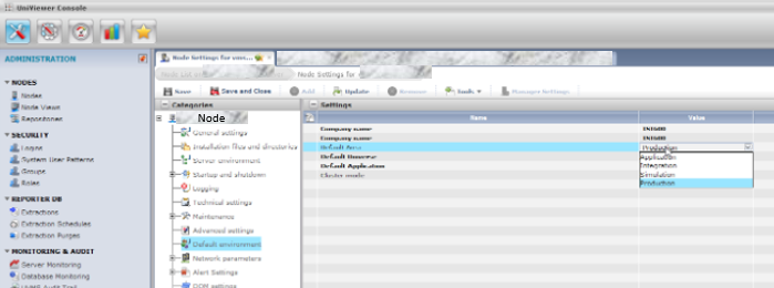

Be in mind that S_ESPEXE default value is X (area X), and only authorized values are A,I,S or X.
The variable should only be set via the commmand unisetvar or via UVC - Node Settings - Default Environment:
