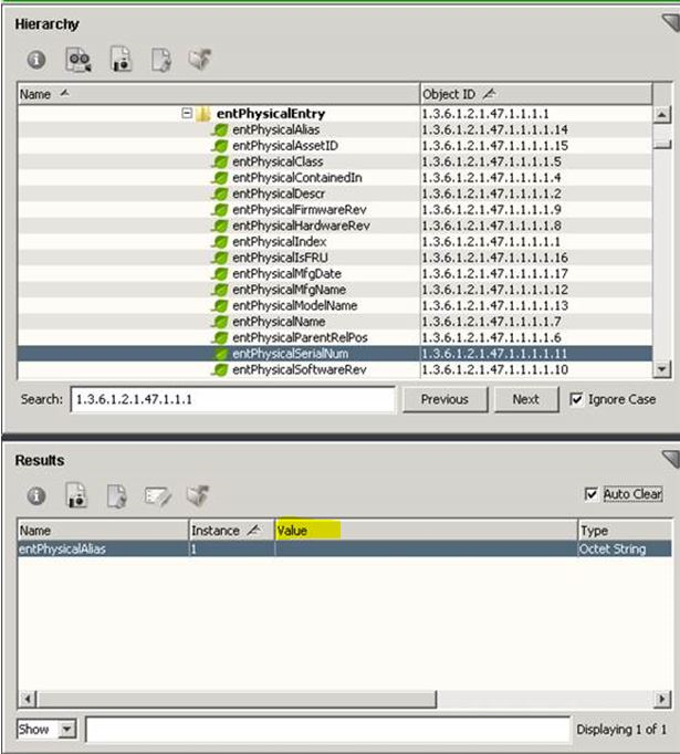

If we look at this oid in mib tools, there is no value associated with it, so Spectrum has nothing to populate.
If this oid should be published, it will need to be discussed with the vendor to find out they do not publish it in the mib.
A third party mib walker tool such as Sapwalk can be used to verify if this oid is populated, before approaching the vendor, if necessary.
