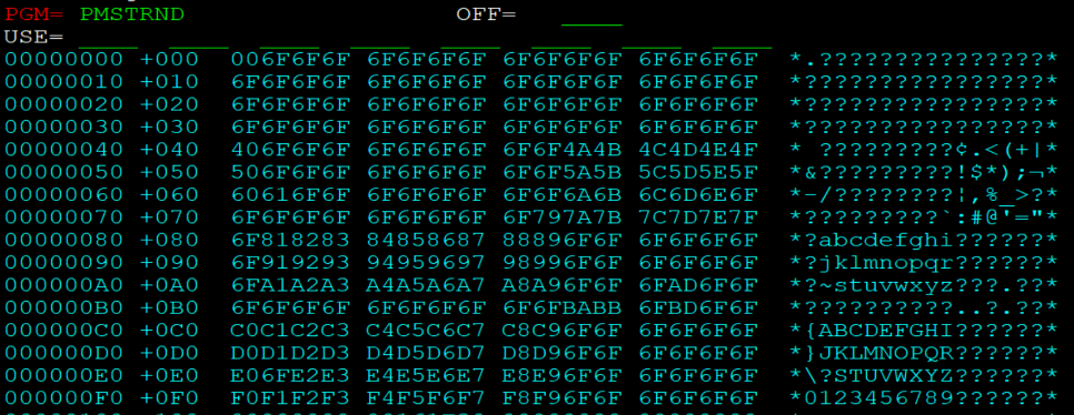

You need to zap module PMSTRND at the offset equal to the EBCDIC hexadecimal value of that special character by replacing 6F by the hexadecimal value representation of that special character.
In HOST CODE PAGE 037 , the Yen currency symbol has an EBCDIC value of B2.
So run AMASPZAP with
//SYSIN DD *
NAME PMSTRND PMSTRND
VER 00B2 6F
REP 00B2 B2
For a list of all displayable character out of the box, issue in IDEAL @I$SCF PGM=PMSTRND. You will dump the load module and see many questions marks. The VER is in place to verify that the question mark ('?') hex character is at that location and you don't accidently replace a character with some other character. Note that there are certain emulator's cannot display certain characters which would be out of IDEAL's control.
