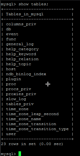

4. At the mysql prompt, enter "show tables;" to see if the servers table is there. The following is an example of the output if the servers table is missing:

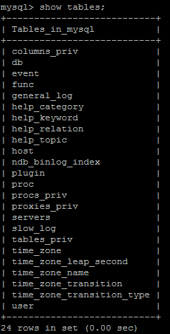

4. At the mysql prompt, enter "show tables;" to see if the servers table is there. The following is an example of the output if the servers table is present:

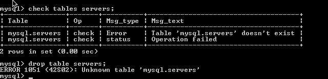

5. If the services table is present, enter "check table servers;" to check the status of the table. The following is an example of a corrupt servers table:

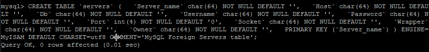

    d. At the mysql prompt, enter "show create table servers;" to see how the table was created. The following is the output:
    e. Note the entire "CREATE TABLE" command used to create the table

    d. If the table is corrupt, enter "drop table servers;" to remove the table
    e. Enter the "CREATE TABLE" command noted from step 1d above to recreate the table.
NOTE: You will need to include a semi colon character ; at the end of the last line of the command
