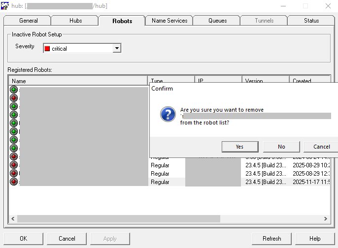

In the Infrastructure Manager (IM), navigate to the hub where the decommissioned robots were connected/previously running.
Then open that same hub probe GUI go to the Robots tab, select the robot and chose Rt-click delete to delete the robot(s).

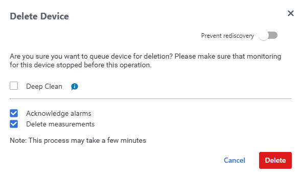

Login to OC and select the Inventory icon/node.
Use the Quick filter and search for the robots/hostnames.
Select the Actions dropdown and delete and then chose the desired options, e.g., delete alarms and measurements, but do not choose prevent rediscovery unless it makes sense for your purposes. Delete measurements prevents further QOS from being generated. The raw QOS data associated with probes that were running on the given robots will age out according to the data_engine raw data retention settings, e.g., 35 days.
After ~30 seconds or less the robot hostnames should disappear from the view.
