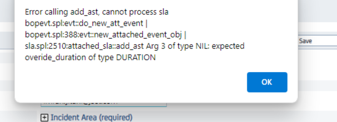

When attempting to save a Service Desk Manager ticket, receive an error similar to:
"Error calling add_ast, cannot process sla bopevt.spl:evt::do_new_att_event | bopevt.spl:388:evt::new_attached_event_obj | sla.spl:2436:attached_sla::add_ast Arg 3 of type NIL: expected overide_duration of type DURATION"
