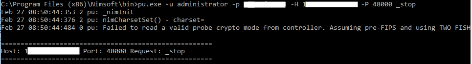

For example, if the robot at 192.168.0.1 needs to be restarted, and the controller is configured to listen on port 48000 (the default), you could use the following syntax:
pu.exe -u administrator -p (your UIM password) -H 192.168.0.1 -P 48000 _stop
This would force the robot at 192.168.0.1 to restart.
