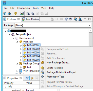

The way to synchronize multiple packages is not by selecting them all and selecting Check Out.  In my test I don't even get the Check Out process when I do that.

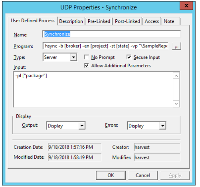

What you'll do is set up a stand-alone UDP, similar to this:
The command you would put in the "Program" field to synchronize multiple directories to a folder on your local machine is:
hsync -b [broker] -en [project] -st [state] -vp "\SampleRepository" -cp "C:\Temp" -usr [user] -pw [password] -sy -av
If you want to synchronize to another computer where the Harvest Agent is running is:
hsync -b [broker] -en [project] -st [state] -vp "\SampleRepository" -cp "C:\Temp" -usr [user] -pw [password] -sy -av -rm <remote hostname> -rport <remote host port> -rusr <remote login user> -rpw <remote login password>

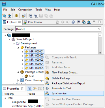

Then you can select multiple packages and run the "Synchronize" process to do the check out:
