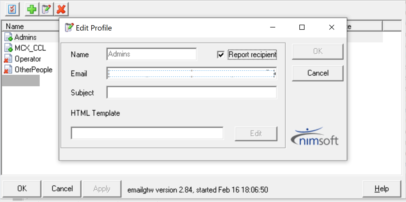

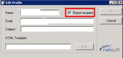

If the Action type for a nas AO Profile is set to EMAIL and the Recipient(s) field is empty, then the emailgtw probe sends an Alarm Report to emailgtw profiles where "Report recipient" is checked/activated.
emailgtw probe sends the report every 300 seconds by default, but the Report interval is configurable here:
Please take a look at the documentation as well.
emailgtw configuration
