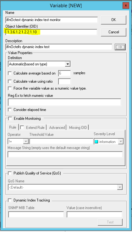

1.  Create a new monitor for the device and in the Object Identier (OID) field on the Variable (NEW) dialogue, enter the table entry OID of the entry you wish to monitor:

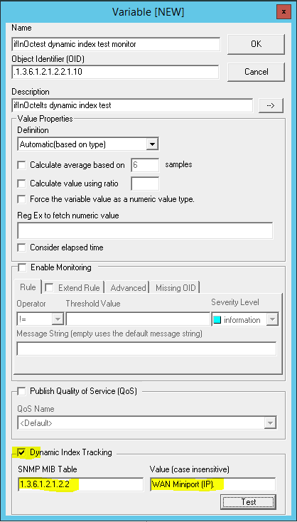

2.  Select the Dynamic Index Tracking option and specify the OID for the table that contains the entry you wish to monitor in the SNMP MIB Table field and a value for the entry in the table that you wish to monitor.  Please note that this value must be a unique value and found in only 1 table entry in the table.  In this example, there is only 1 entry with an ifDescr value of "WAN Miniport (IP)."
3.  Select the test button to allow the probe to fetch the current index:
4.  Complete configuring the monitor to meet your monitoring needs then select the OK button to save the profile.
