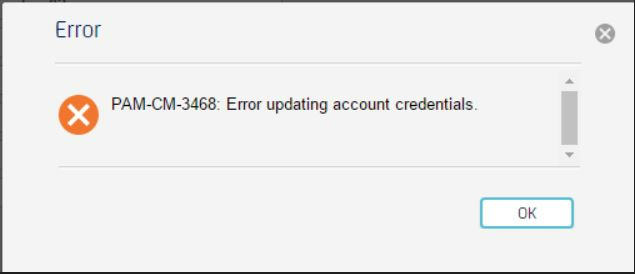

When updating an account password using the proxy windows service, an error message is displayed : "PAM-CM-3468: Error updating account credentials".
And  “5-ERROR_ACCESS_DENIED” is shown in the Proxy logs.

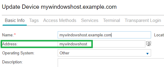

  1. Go to Device > Manage Devices and edit the Device.
  2. Modify the Address Field and replace the FQDN address to an IP-address or (Hostname). Afterwards the account password update should work.
