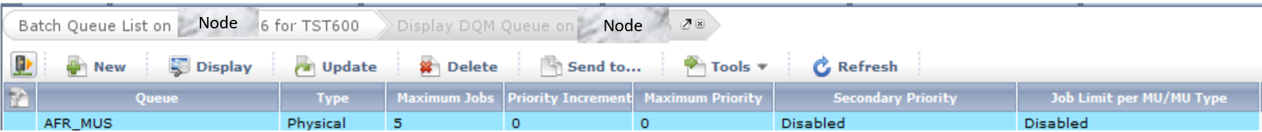

  • Graphical Issue: UVC does not allow to modify / enable the "Job Limit per MU/MU Type"  on a Batch Queue, the option is always shown as Disabled and the content is not displayed correctly via UVC.

If we try to display it with UVC we don't see the Job Limit per MU enabled, neither the List of Management Units.
