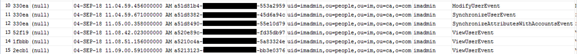

Auditing collects a lot of Data, but there are certain Events that we don't need to see like for example ViewUserEvents.
Here is a sample of the database showing the ViewUserEvents:
How do I filter out Events in the Auditing
