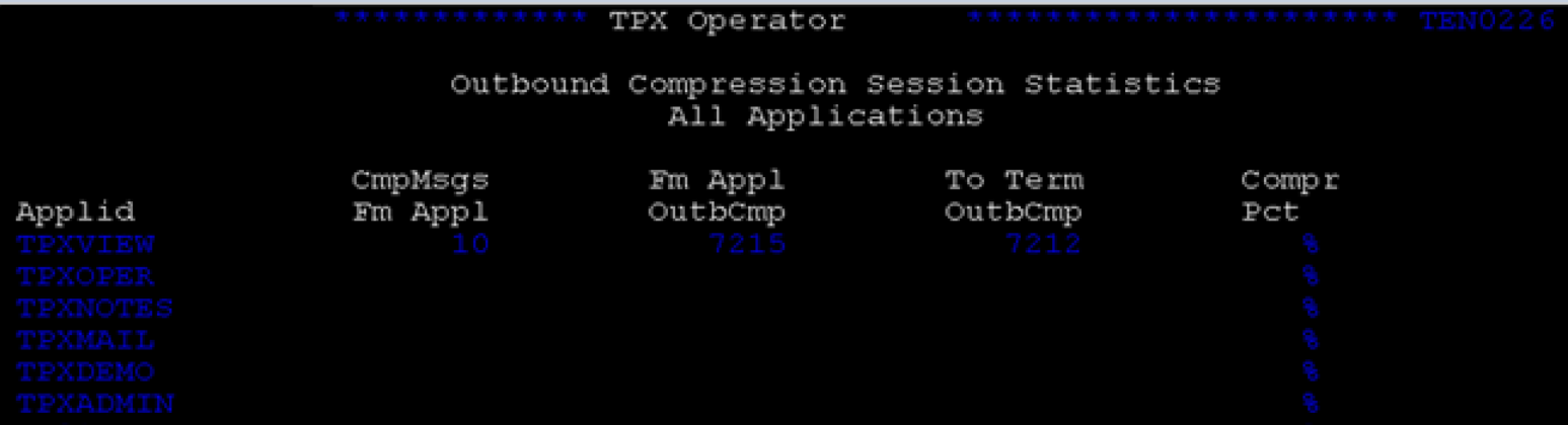

We are considering removing the LMP key O0 for the TPX ADC option. How can we verify whether we are using this option or not?

To check ADC, issue the "D STATS" command in TPXOPER and then PF11 (right). The last column is compression percentage. If this is empty for all applications then no compression is occurring.
