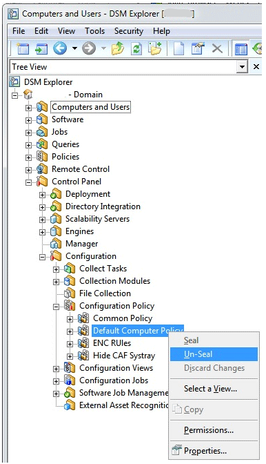

ITCM has the ability to set DTS Parcel Size and Throttle factor via Configuration Policy settings in DSM Explorer.
Open DSM Explorer and browse to: Control Panel->Configuration->Configuration Policy->Default Computer Policy
Right-click this policy and select 'Unseal':
Now expand the policy and browse to: DSM->Software Delivery->File transfer
You will see two settings called: DTS: Default maximum parcel size and DTS: Default throttle factor
Set the desired values and then right-click on the 'Default computer policy' and select 'Seal'. The change should apply within a few minutes once policy updates apply to the system.

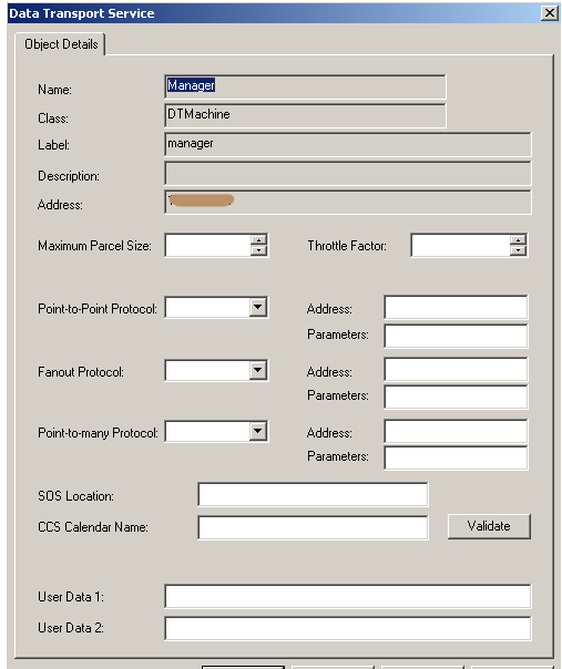

Solution 2:
  • Open 2-D Map by navigating to Start->Programs->CA->CA Common Services->World View->2-D Map or executing 'catng2d' from the command line.
  • Browse to the DTS Manager Machine (TCP/IP Network -> IP Subnet -> IP Segment)
  • Right click and choose 'Open DTS Details'
  • Type the User Name and Password when prompted
  • Configure the Maximum Parcel Size and Throttle Factor as per your requirements
