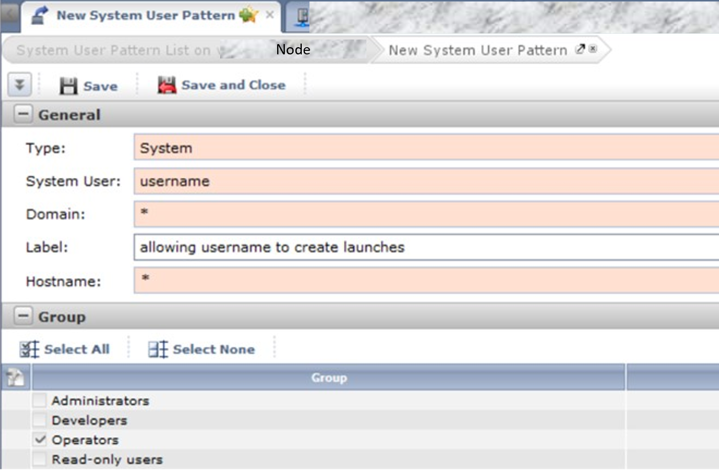

To fix it, create a "System User Pattern" for the user that will launch the command, here you have an example where we will map the user called "username" to the group "Operators":

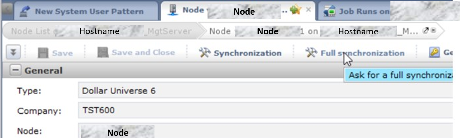

Then perform a "Full Synchronization" of the node so that this new proxy is pushed to the node.
