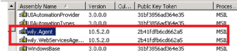

1) Verify that the correct version of wily.Agent.dll has been registered in the GAC (c:\windows\assembly)
For example after installing .NET Agent version 10.5.2
If not listed, you need to register it manually, drag and drop AGENT_HOME\wily\bin\wily.Agent.dll into C:\Windows\assembly

  • Scrennshot of the C:\windows\assembly folder, listing the wily.*.dll
