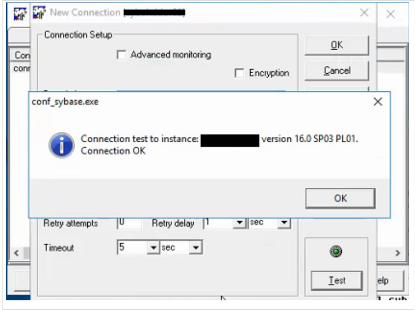

Deployed sybase probe but it crashes and we cannot successfully configure a connection to the Sybase database server instance.
The connection test threw an error ending in:
...The parameter %1! cannot be NULL

1. Deselect Advanced Monitoring and Encryption since as of version 4.2 onward, the probe does not support Advanced monitoring using Monitoring Server. This is because the Monitoring Server is not a part of the Adaptive Server Enterprise version 15.7 and later.
Servername in the IM GUI for the sybase probe MUST be configured using the correct instance name (as per the sql.ini file on the Sybase Database Server) so that should be checked to confirm. No port was specified in the Server name field just the instance name.
2. In this particular case, once we edited the Sybase connection setup and specified the correct 'Server name' as the Sybase instance name (re-confirmed via the contents of the sql.ini file), then the connection test was completed successfully.
